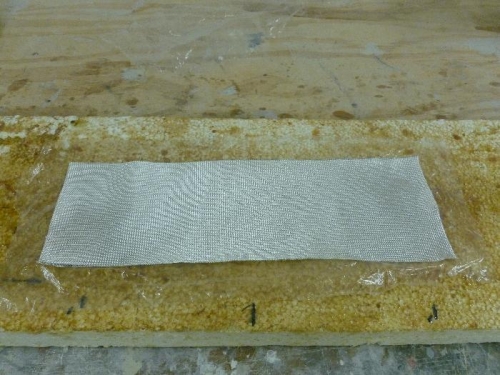

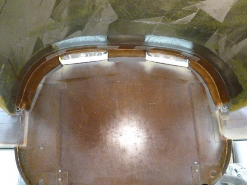

Brief Description:  Cut bid and did a 3 bid lay-up for upper cowling
I started tonight duct tapping the area for release and then cut the bi-direction cloth for the 3 bid lay-ups to go on and then come off when cured. The bottom of the lay-ups will be structurally glued to the firewall for the cowling to slip into for holding in place. After everything is set and in place the stainless sheeting will go on and then set up for measuring were the engine will go.
The start of the lay-ups
Lay-ups are done
Lay-ups are done
