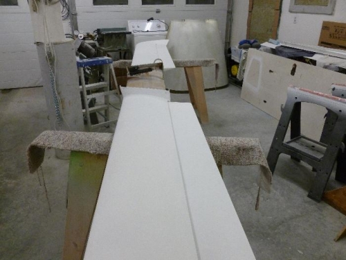

Tonight I clean up the shop and will be storing the canard up onto the center beam in the shop. The canard was reassembled for storage. The dog house has a place now up and out of the way.

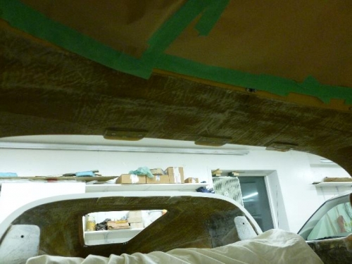

If I can pass anything onto a new builder I would sand the entire inside of the fuselage. Sand the bottom half and the top half of all the sharp edges and ridges from the plastic forming process before the 2 half’s are joined together. It is only resin on top of the fiber glass that was formed and is very sharp and cuts your hands when working on the airframe.
Elevators back on canard
Sharp edges sanded
Sharp edges sanded
