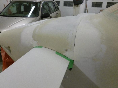

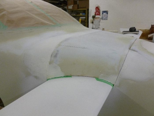

Brief Description:  Dog housed sanded, micro on, front hatch filled
I sanded the micro with the long block and filled the pinhole. I used the razor knife to cut a line after application and before it sets. I saw a spot I forgot to cut and it was hard to get the knife through.

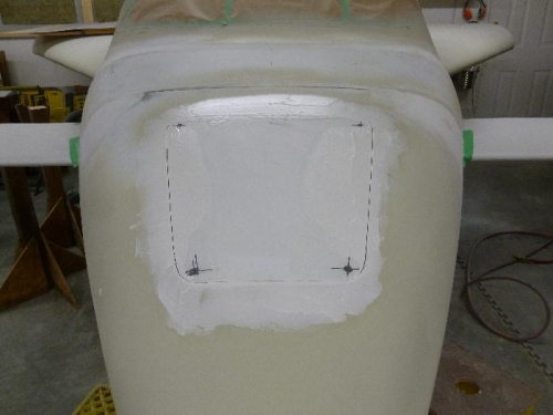

The front hatch got micro filling as well tonight, duct tape is on the edge and it he cover should just come off hit a good hit tomorrow.
Sanded and pinholes filled
Hatch got some work
Hatch got some work
