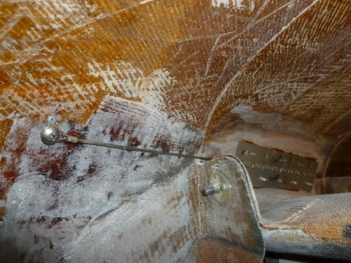

Date:  1-15-2016
Manual Reference:  6.8.2
Brief Description:  Soldered eyelets on the ends of the rods
I started to insert the pins and ripped my hand on some of the glass that not smooth, so out came the sander and cleaned that all up and got the hard to get areas by hand. The pins were a bit hard to get in and I found the surface was not smooth and they got some sanding too. I soldered eyelets on the ends of the rods; they can now be screwed to the side of the fuselage. After painting they will get some oil and will work better .
Hinge pin in place with screw
