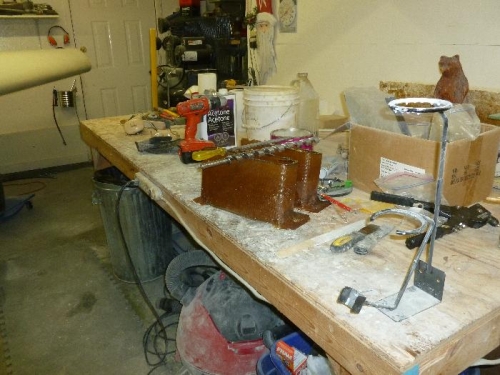

Brief Description:  Removed NACA outflow funnels and trimmed
The glass work from yesterday had set up enough to be removed so off they came. If it was structural I would have waited the 48 hours, there is a few stress spots from the pulling and foam removal but no problem. I used a big boring drill to make hole in the foam and then a rasp file to hog out the foam. It was a little work but I didn’t won’t to melt with acetone and stink up the place so I drilled out the foam instead. I will leave the sanding until tomorrow it is still to green for that.
Foam is out and trimmed
