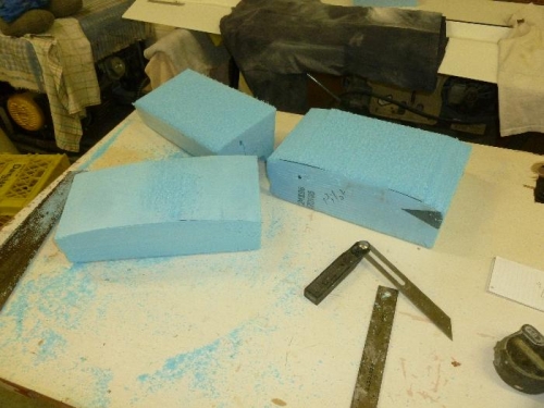

Brief Description:  Engine cooling plenum chamber
Well it's time to start working on the engine part of the plane. The engine install kit was not part of the original kit from the factory due to not knowing what engine was to be used.
I will try to make every thing myself from the air intake to the engine block and foam will be used to make the shapes for fiber glassing parts.
The foam was cut over size and will be sanded to shape using the aluminum sanding block that came with the kit.
Contouring foam for 3 bid lay-ups
