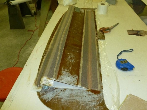

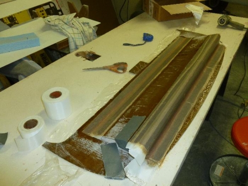

Brief Description:  Modify instrument panel so it is 20 degrees and fa
I did some measuring and cut out the center of the instrument panel for the glass panels to go into.The glass panels will be leaning away from you at 20 degrees so the cluster will be facing you and easier to see. I tried a few angels and the Toyota Rav 4 is at 20 degrees so I went with that. There will be just enough room centered on top for the compass and room on the bottom for switches. The left will have the throttle, prop and lean engine shut off. The right side will be for the fuses. It should all fit in there nicely.
PS The heat gun is the way to do nice lay-ups and less resin.
