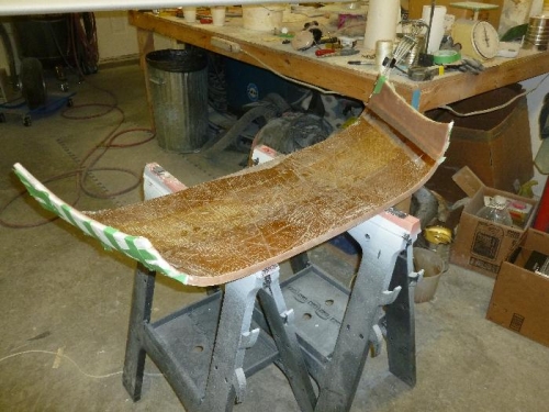

Brief Description:  2 bid on inside of dog house @ canard.
Tonight after dealing with 3” (7) cm of snow I mixed up some micro and filled in the foam and laid down one bid and then wet out with the heat gun for better flow. The second was added , wetted then and peel-ply was added and taped back to round the corners and hold everything in place so it could be lowered into the fuselage. The corners are pushed in 1/32 – 1/16 under flush with the fuselage just incase it springs back out and if not then just a small amount of filler will be needed.
2 bid and peel-ply
2 bid and peel-ply

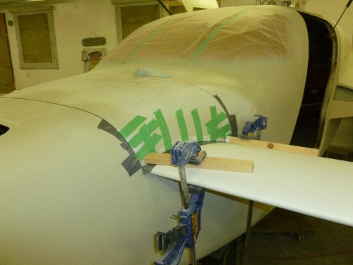

Corners are pushed in
In 1/32- 1/16
In 1/32- 1/16
