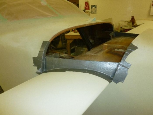

Brief Description:  Dog house is to wide at canard and needs to come i

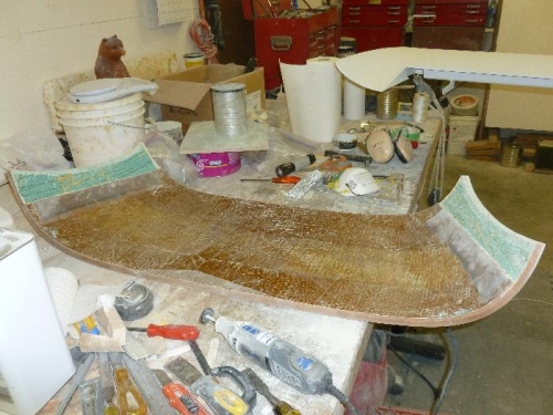

I got the bottom to the right curve now and right height the only thing now is that the bottom sticks out from 1/4” – 1/8”at the bottom corners. I β€˜m not going to fill this much for blending so the next thing to do is reshape the curve at the triax and bring in the bottom in line with the fuselage. The inner glass was removed and I will do a 3 bid lay-up with micro over the foam to finish the shape and strength. I have lots of room to move in so the 3 bid will work well here.
Glass remove on bottom
Taped for release
Taped for release
Taped for release
Taped for release
