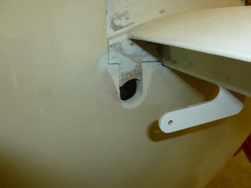

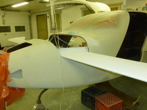

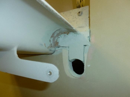

I cleaned up the glass work from the other day and got the canard back on the plane for the fill in over the canard elevator torque tubes to be fitted better. I used masking tape on the fuselage and filled in and then cut to make the gap better. I just kept filling and sanding with the canard up and down until it is ready for primer now.
The dog house will be fitted next. Due to the center of the canard being heavily filled in the dog house bottom will have to be reshaped to fit.
Cut with hack saw for lines
Top is filled for dog house
Dog house will be next
