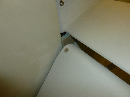

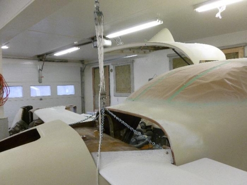

I started filing the micro from yesterday in the over cut at the elevator torque tubes. I set up the block with chain and got rid of the ropes I was using on the dog house triax. I had the canard up and down at least 20 times today fitting the tubes, fuselage area under the canard and bolt up. I spent a lot of time making the plugs to go over the elevator torque tubes and still not done with this.

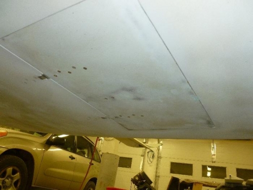

The speed brake went back on and clearances had to be sanded and worked out since I did filling and priming on the brake. Every thing works good there now.
Much needed set up
Much needed set up
Removable plug to keep wind out
Speed brake back in
Speed brake back in
