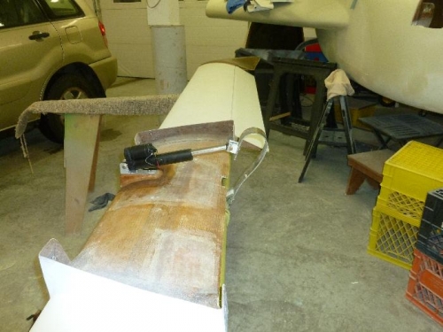

Brief Description:  I got the trim actuator set up and bolted
The elevators had to go back on to set up and finish the trim actuator. The base screws had lock tight added and every thing was lining up and working out very well tonight.

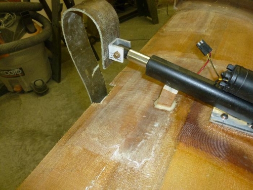

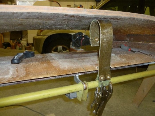

I have 1.5” up elevator and 2.25” down elevator. I then drilled the torque tube from both sides from the predrilled clip that I had done earlier. The safety block was then cut and glued on with T88 structural resin and flox mixed in.
All set up and working
2.25
2.25" down Which is up airplane
Safety block with T88 and flox
