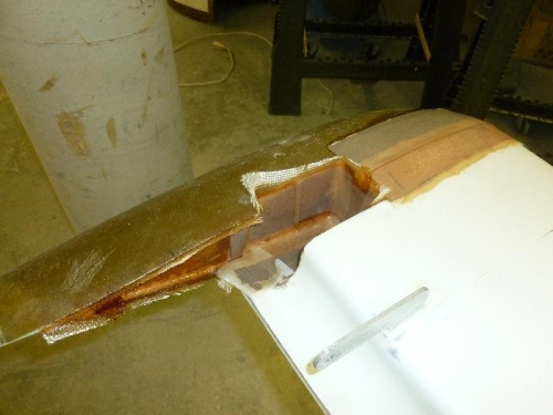

I clean up the treaded holes for the trim base and flipped the canard over to start on the ribs and box in the canard tips. No wasps can get a free ride here. I still had fuel strake rib foam from the 4x8 sheet left over so that is what I used to fill in the canard tip weight pocket.

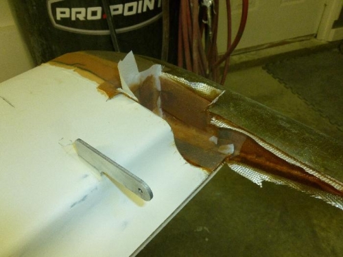

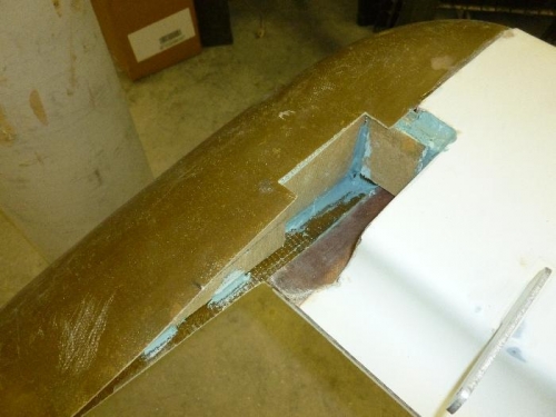

I bondoed every thing in and installed the elevators and tried the movement and the weights hit the back box section so out came the hacksaw and I made adjustments and now every thing had lots of room. Off came the elevators and out came the dermal and cleaned every thing up for a smooth micro fiber glass job to be done. I mixed up micro and radiuses the Pilot side and then wet out for the glass to go on. Once all the fiber glass (one bid) was on and wetted out I used some peel-ply to soak up the extra resin. There was still time and resin so the one bid went on the front bottom canard tips as well.

Wells are boxed in.
Wells are boxed in.
Micro, one bid, resin, peel-ply
One bid on front tip
