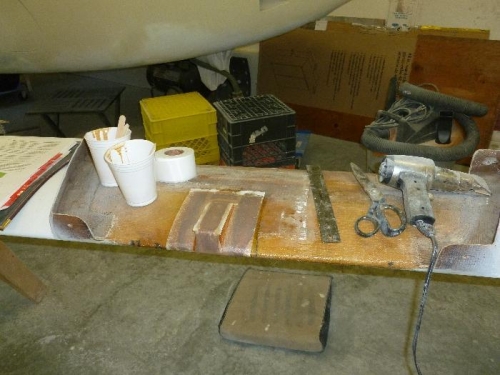

Trim base

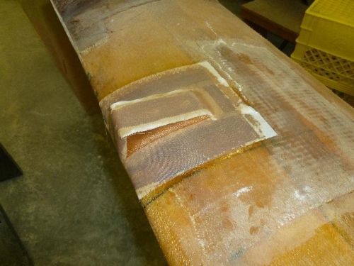

I shaped some foam for the base an sanded everything up and did the 2 bid lay-up to hold in place
Again the bid will only lay down on rounded edges so that was the prep that needed to be done.
WOW 2,000 hours into the kit now!!!! I hope I'm over 1/2 way
Base in place
Trim plate next to fit up
