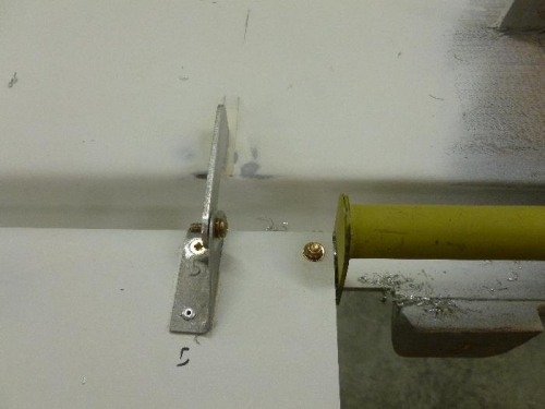

I started the day sanding around the hinge arm and cleaning up any micro that was in the wrong place.

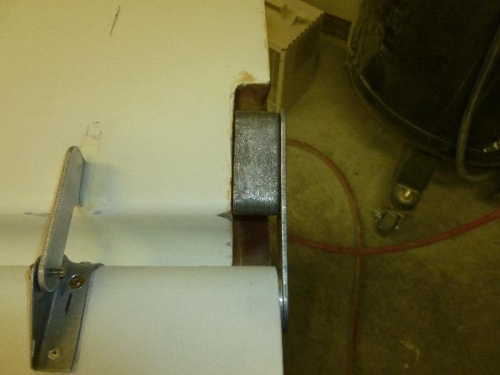

Cynthia and I went for a 10 km X country ski and then it was back in the shop to level and bolt up the elevators to the torque tubes. Every thing worked out very well with 34 degrees of down when only 28 is needed. Up is 24 and that will be increased with sanding to 26
The counter weight well needs to be wider and I will work on that tomorrow.
Need to remove more
Need to remove more

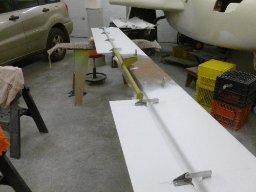

Torque tubes in place
Elevator is bolted to tube
