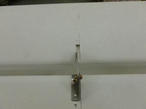

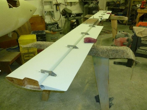

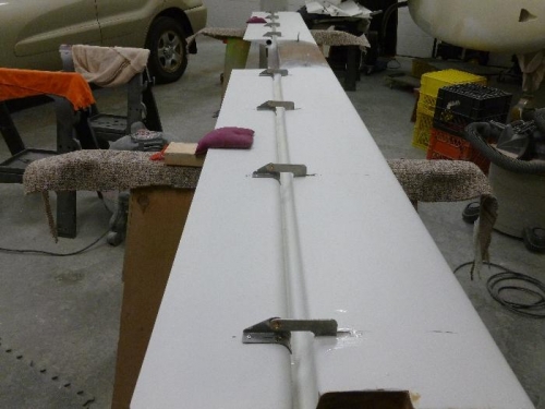

Tonight I got things ready for the hinge arms to go into the canard and things were going so well then I mixed up the Alhapoxy and micro balloons and poured it into hinge arm holes. I triple checked the measurements and level on everything and it is all bang on. The hole for the arms goes from the canard spar to the glass at the back so the tie in will be as strong as I can get it. I will let set over night and work on something else tomorrow.
The arms are all at 0 degrees
Arms are centered
Arms are centered
3rd check on all stuff
