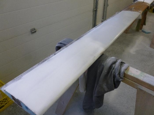

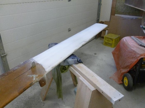

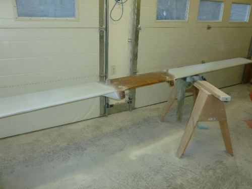

I sanded the canard and spayed out the sealer primer and let set for 3 hours and then filled the pinholes, voids, and scratches with Spot – Lite bondo and word with that and now the canard is ready for K2 primer.
Micro sanded and primer going on
Micro sanded
Canard seal primed ready for spot-lite
