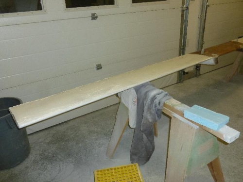

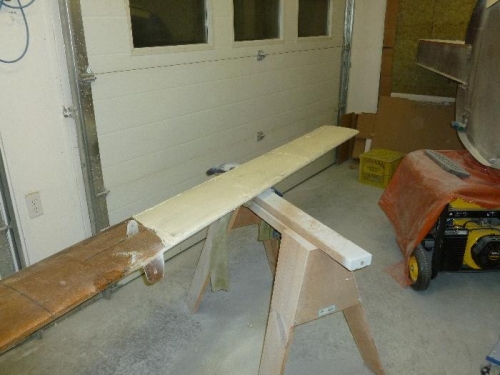

I prepared the bottom canard for micro and mixed up (4) 120 gram resin batches and applied to the lower side. I will get to primer state before cutting to length and width.
Time for Alhapoxy micro
Ready to sand next day
