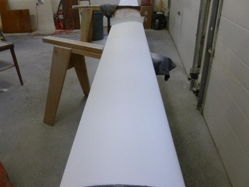

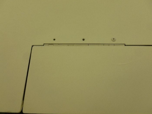

I started sanding a few high corners and spots on the ailerons so they will match the wing flow now.

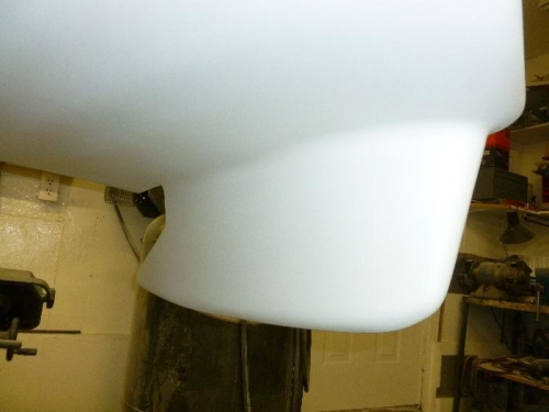

There was a low spot on the bottom winglet that just didn’t feel right so after a few applications of Spot – Lite it was fixed and ready for primer.
Now it was time to spray out the Smooth Prime on the areas and the Canard one more time. I’m getting the hang of the Smooth Prime, nice and thick, hot shop, big size for gun and fog coats every 15 minutes.
This was all to be done in the summer with nice hot temperatures, O Well
High spot sanded down to blend
Sight of rare beauty!!
Low area filled - sanded - primed
