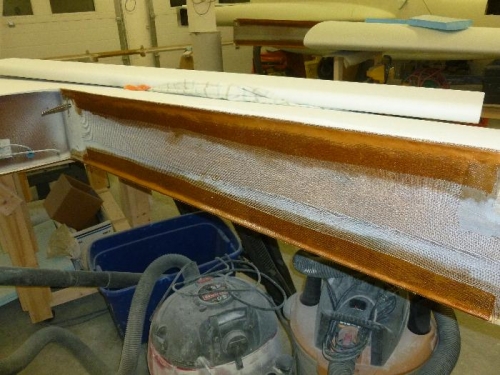

Brief Description:  One bid on strake to wing at wing spar

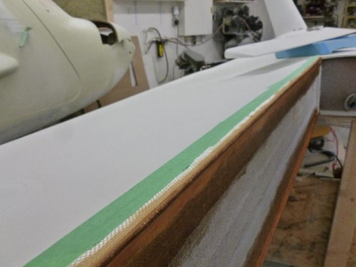

It was time to finish the micro radius on the stake end that goes onto the wing spar. I mixed up some micro and filled in the voids and then wet up the area and applied the one bid (fiber glass cloth) and finished wetting out with the heat gun and resin. I used bid tape for this and it worked ok but I ready don’t like the stuff for corners so masking tape was used to hold it back so it would stick to the face.
I trimmed up with the hack saw blade 24 hours later and will sand in 48 hours.
Tape to hold bid back
Bid was trimmed next day
