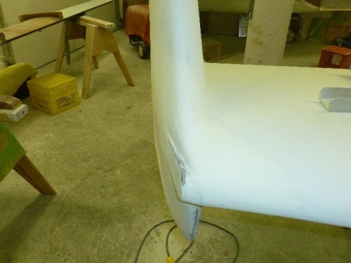

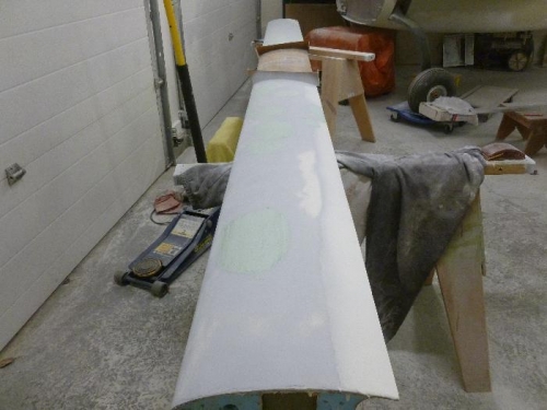

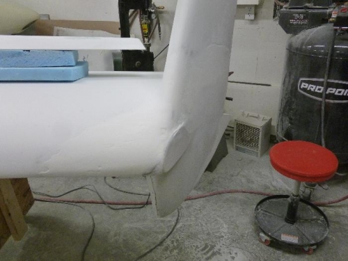

Brief Description:  Sand and fill on Canard. Sand on bottom winglet.
I started sanding on the Canard micro from yesterday. The camber is so close to perfect now, the low areas will get spot-lite bondo and then start to prime and block.
The winglet bottoms were a lot of work sanding up-side down. I knocked off the high spots with the orbital sander and hand sanded with a block and 50 grit paper. It is taking shape and only a few more application will be needed to get to the primer stage.
