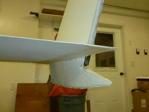

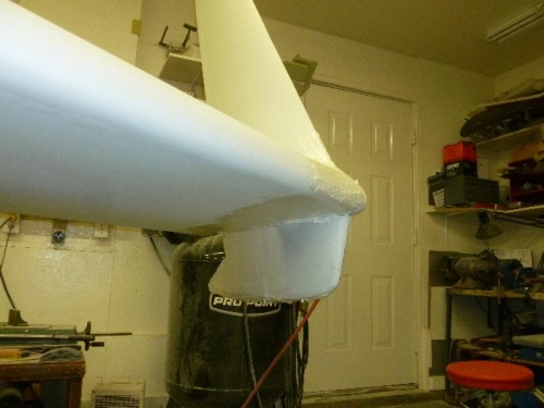

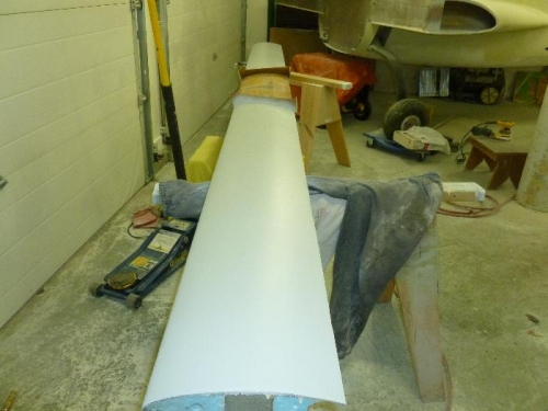

Brief Description:  Sand and prime Canard. Fill winglet bottoms
I started the day sanding and filing the bid and make sure clearances were still good before filler was added (Alpha-poxy and micro balloons). I then sanded the canard and shaped for the first shot of primer sealer. It was now ready and I mixed up the goods and sprayed out 3 coats. I will let set for 3 hours before sanding and adding micro to the low spots. It was time to mix up the Alpha-poxy and ice up the winglet bottoms.
Sealer primer was used to cover micro
Icing was added to the bid foam
This may take 3-4 times before pimer
