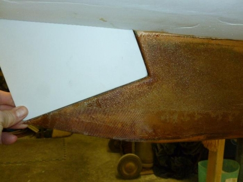

Date:  10-10-2015
Number of Hours:  3.00
Manual Reference:  14.2
Brief Description:  One bid over foam to increase strength and get rea
I had to make sure all the clearances were good before the glass went on. The foam was also sanded and shaped. I mixed up Structural resin and micro balloons and painted onto the foam and then added the dry one bid to the wet slurry and wet out with the heat gun adding resin were needed. Peel-ply was used to help make things smooth. It work out very well and the filler will finish the transition from foam to rudder.
Bid cured and ready for Micro
