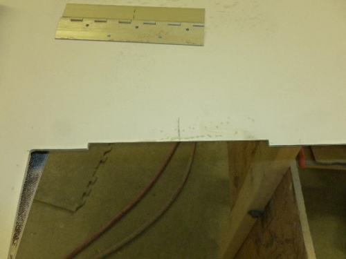

It was a good day in the shop. Rain out side means building inside. I started fitting the ailerons into the wing after the make over to primer. Areas had to be sanded heavily to have clearance and the fit is good enough to mount the hinges and then I will go over the spacing and fix that up at a later date.

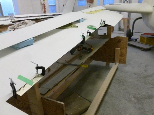

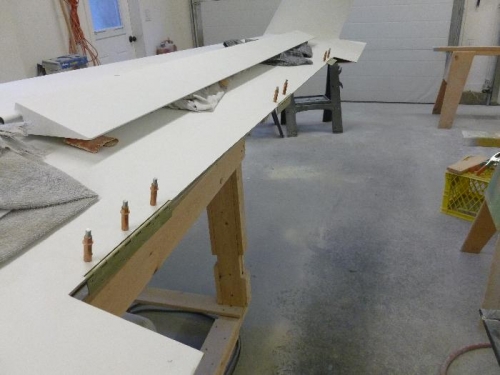

The palm sander was the work horse today but the file and sanding blocks took the time in the fine finishing. The tape holds the hinge up so the straight edge can be used for alignment. It lined up very well so out came the drill and clecoed the hinges in place.
Wing notched for hinge
Time to drill
Time to drill
Hinges are clecode in place
