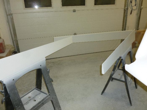

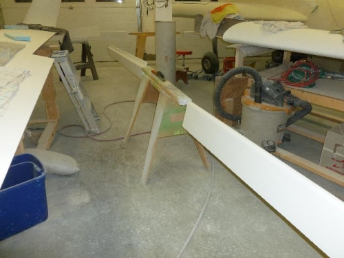

Brief Description:  Block sand and fill to Smooth Prime
It’s been some time since I last worked on the plane. I block sanded the control surfaces and filled the imperfections until I was happy with the results. I then set up to spray on the Smooth Primer and sprayed on 4 fog coats to get complete coverage and no runs. It seams to go further as there is more solids then the solvent based primer.
The control surfaces are now ready for mounting after I get the wings ready to receive them. The Canard will come down now and get the filling process to primer also.
All primed up ready to go on
