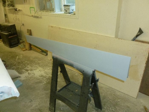

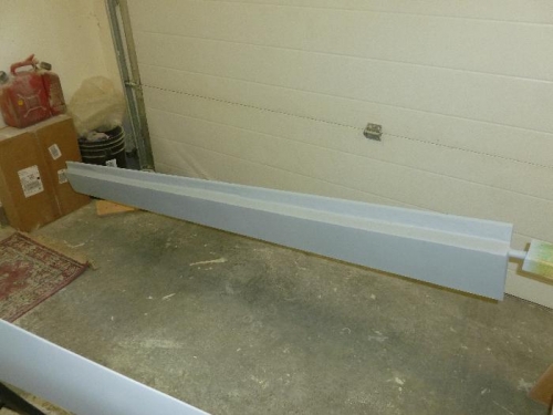

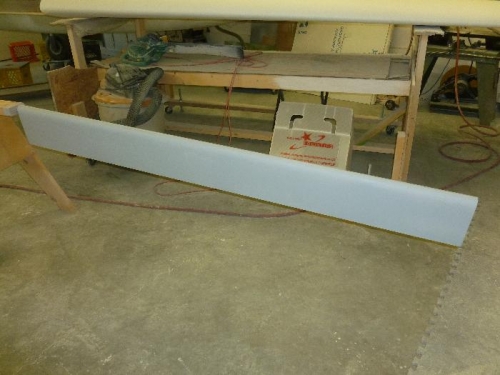

Brief Description:  Sanded the micro and primed the control surfaces
I finished sanding the rudders today and got things ready for priming. The elevators got there first shot of primer sealer. The Ailerons and Rudders got 2 coats as well on the micro areas and the gun was sprayed out covering needed spots.
I will be changing now to Spot-lite bondo for pinholes and feathering low areas. On the elevators were the glass is over the foam will need Smooth Prime painted on by hand so the it will fill the pinholes better then filler.
Filler management is time management, the Velocity factory must have this down to a science.
Elevators sealer primer

Ailerons got a nice coat

Rudders are coming along
