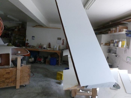

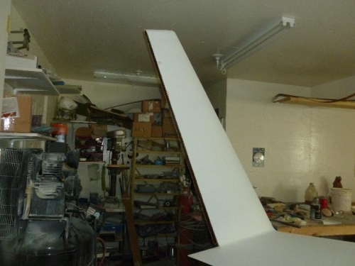

Brief Description:  Trim winglet wells and rudder wells. Glass rudder
I got out the hand hack saw and cut the extra glass that was out side of the winglet well and it is now ready to be sanded and then primer.

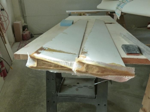

The rudder ends got the ends microed and 1 bid wetted on with peel-ply
Peel-ply removed glass trimed
