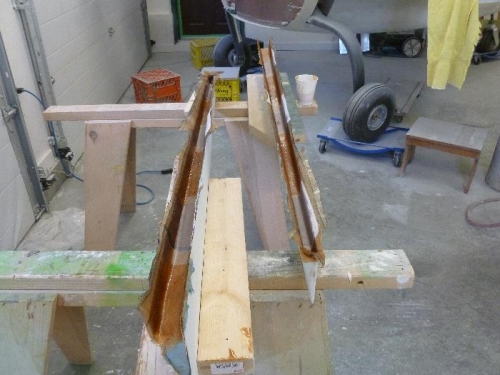

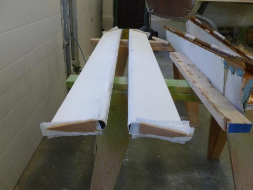

Had to take time out to cut bid this morning before I got started and then down to the shop to place in the rudder wells. I mixed up the micro slurry and painted onto the foam and it level very well filling all the low areas for the glass to lay down flat on. It was time to pre wet the sides and then the bid. After all the bid was done on one rudder the hinge extra glass (bid) was wetted out and applied. After the rudders were done I then applied the peel-ply.

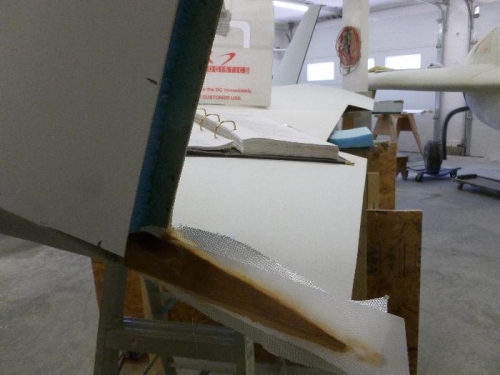

I had time and stuff mixed so the elevator end got done.
Now as I write this I’m thinking that I may have got ahead of myself on the wing ends at the rudder location as I still need to fill and prime on the rudders so this may have to be removed. Nothing the hack saw wont fix.
Rudders with 3 bid and 6 at hinge

Elevator ends got done
I might be ahead of myself
