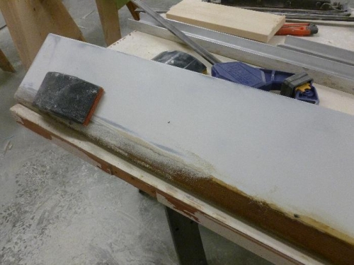

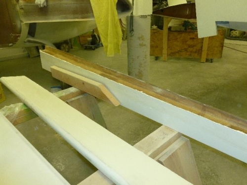

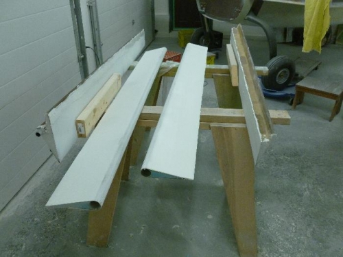

Brief Description:  Sand elevators and ailerons were the glass butted
I’ve been blocking out the elevators trying to get straight and level. I had to add Alpha poxy micro to one bottom elevator side and will sand out next time I’m in the shop. The ailerons got some loving tonight as well I had to sand the excess resin and bid off the but joint area were I ground out for the 1 bid to go on it was time to micro up the ailerons and get ready for sanding too.
Glass but joint sanded
Alpha poxy micro on elevator
All microed up for the night
