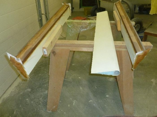

Brief Description:  Glass ends of ailerons and cut hinges

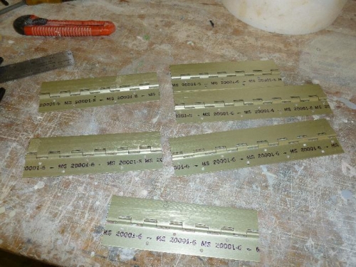

I got a few things done tonight first was the bid on the ends of the ailerons with peel-ply on them and then I got out the hinge and cut to length. The manual states to remove the hinge pin and flip the hinge over then cut to length. Being tired from a fire I attended last night I thought I would cut the hinges and then flip, well things came up short the hinges were off set by ½" an inch so the hinge ended up being short so I will have to order more hinge to complete the job. DONE

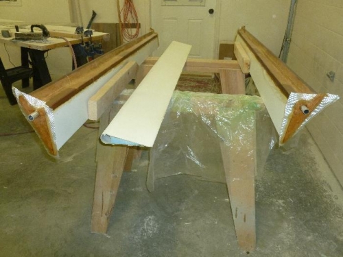

I weighed the ailerons tonight and they came in at 8 pounds things will be good on the weight.
In-word end glassed
In-word end glassed
out-word end glassed
Hinges cut and drilled
