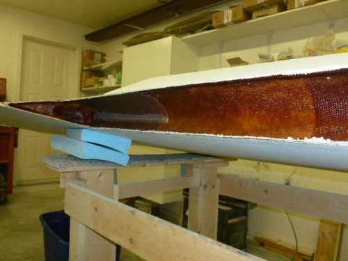

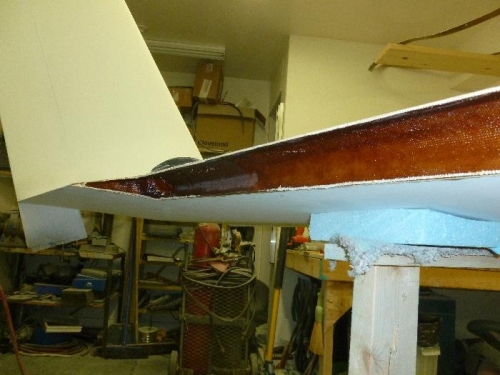

Brief Description:  Trim bid at the edge of the Aileron well
The bid (glass) had set up enough now to trim back and get ready for sanding and to define the edge better. I took my time cutting I did not what the bid to pull away from the face it was glassed too.
Just before I went to work this morning I had a look at my work from last night and found a few air gaps so I poked a hole to let the air out and push down into place. The heat from my hand was enough to get the resin to bond with the micro on the foam and it was good when I got home tonight.
Co-Pilot side wing aileron well
Pilot side wing
Pilot side wing
