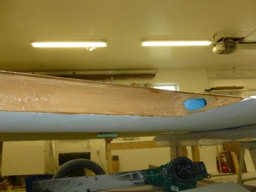

Brief Description:  Glassed in Aileron wells tonight

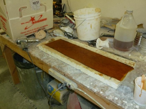

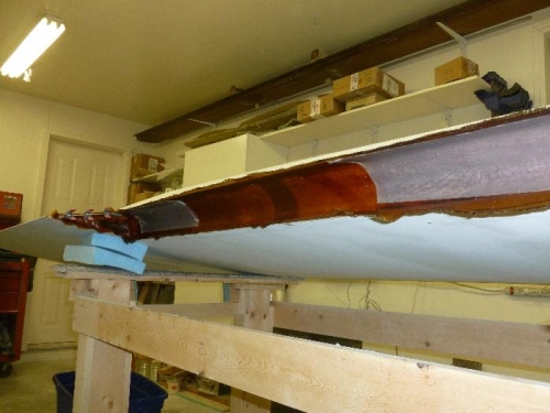

Well tonight was a long one I finished prep sanding and got at glassing in the wells. I got my slurry mix just wet enough to paint on and then thickened with more micro balloons to radius some transition areas to eliminate air bubbles. I use my trusty heat gun to flow out the resin and get a saturated dry lay-up. I then would let cool and off to the wing and put in place. The hinge areas got 6 bid in total for the extra strength.
Slurry was painted on
3 bid ready to go. Cooling off
Wells area done & 3 bid on hinge areas
