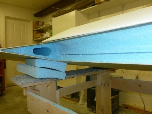

Brief Description:  Sand more on aileron wells

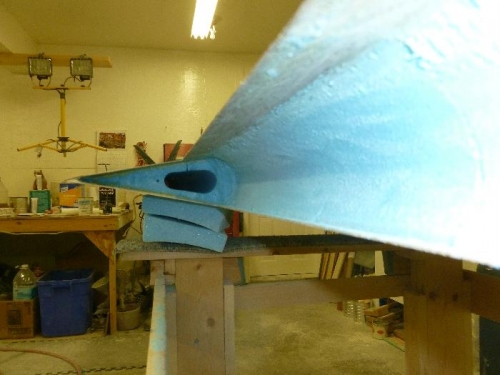

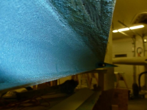

I had the Pilot wing to sand in the Aileron well so I got that done. I was thinking that the swing down will need to be right so in Finishing 14.1.4 of the manual it states that the deflection up and down is 2 ½ “. I did a swing down with the top touching and found that a lot of foam had to come out ant that pen mark. Grind and sand and now I have 3 ½ “of deflection. This will leave room for the 3 bid in the well and another 3 bid at the hinge and the 1/8” the balance rod sticks out. I don’t wont to find that I came up short on the deflection.
Line indicated were it hits
Foam removed for clearance
Pilot wing is ready
Pilot wing is ready
