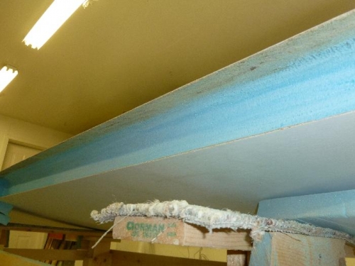

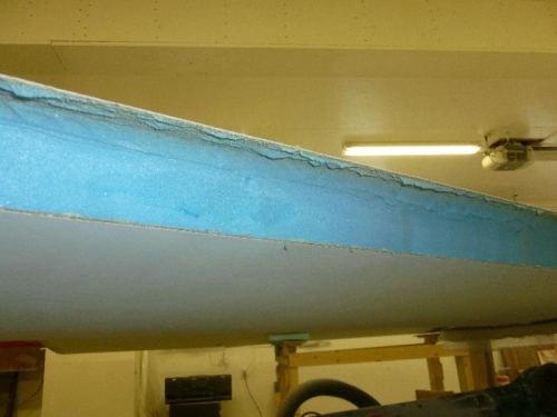

Brief Description:  Aileron well grind out and sand to shape.
The wells took some time to grind out and sand to shape. I used a chisel to get into the corners and the ends then sanded as best I could to get ready for glass work. The deep voids will be filled with micro before the bid goes into place to eliminate air pockets. I will most likely use the brush to apply to the foam and not have the micro to thick the ends will be a different application combination of brush and tough depressor.
Ground and sanded to shape
Ground and needs shaping
