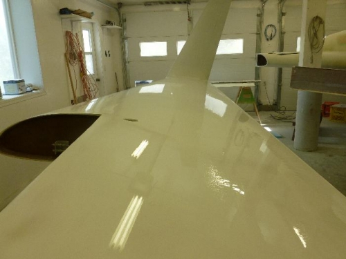

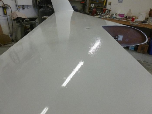

Brief Description:  Filled last low spot and Smooth primed wings
I found one location on each wing in the foam joint area under the bolt access that needed filling, so once this was done I sprayed on Smooth prime and blocked out.
I had to up the orifice size on the water born gut to spray out the thick Smooth prime once I did this the product worked out better for me by not having to thin out as much.
My wet test was just water sprayed from the gun to see if there is any big spot needing filling. The wings look great to me just more blocking before paint now.
Elevators got some micro as well and will need a second coat for pinholes.
Wet test. Sprayed water on.
Wet test. No big stuff to do.
