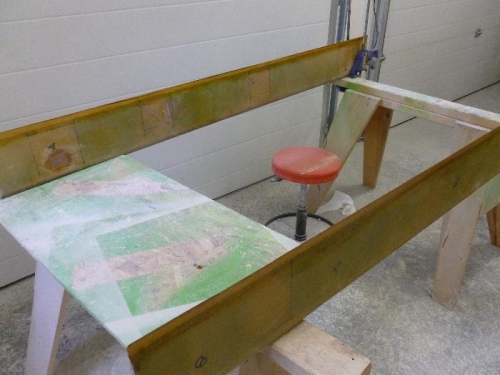

Brief Description:  Resin work on trailing edge of elevators
I guess in the trimming or transportation the trailing edge of the elevators had some delaminating of the cloth. I got out my best tool the heat gun and mixed up some resin and brushed the edge of the trailing edge and heated the resin with the gun pointing at the end of the trailing edge straight down and watched it flow down between the layers until it was full and a uniform color showing no air between layers. I had brushed the edge 6 times on each elevator to get complete saturation.
The repairs from yesterday turned out good and only need some sanding before micro goes on.
Trailing edge done
