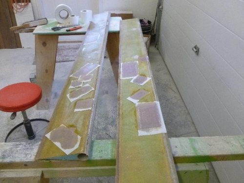

Brief Description:  Fix air voids and delaminating in elevator
Fix air voids and delaminating in elevator was one of the jobs today. They were found in the pre-cover inspection and had to be fixed. Not a big thing I ground the on layer off and microed the resin in with the heat gun then did lay-ups to replace the ground out cloth. It worked out very well.
Air bubbles ground out

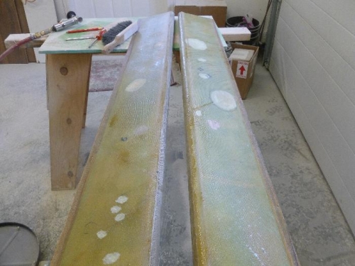

Few more spot that need work

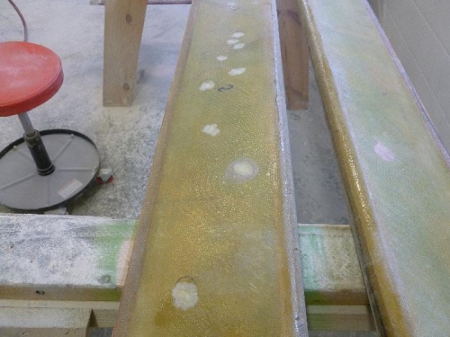

All fixed and will be sanded later
