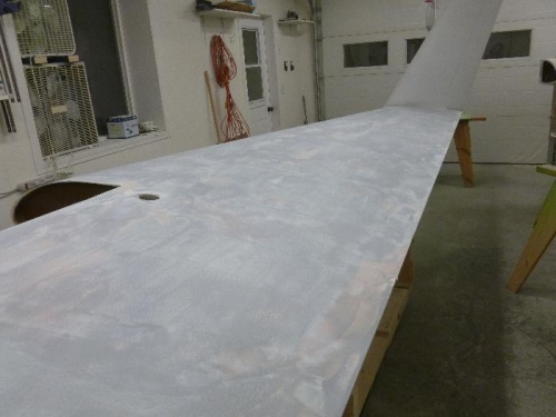

Brief Description:  Spot-Lite bondo is the tool to use for me

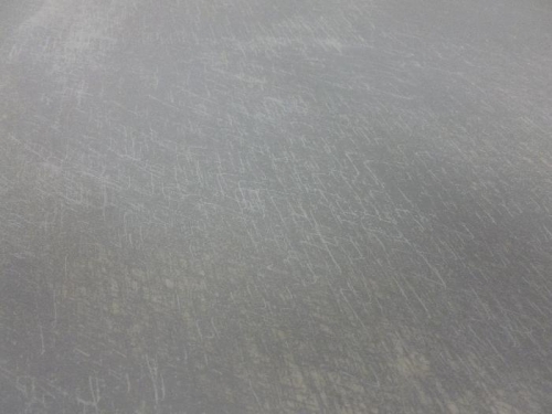

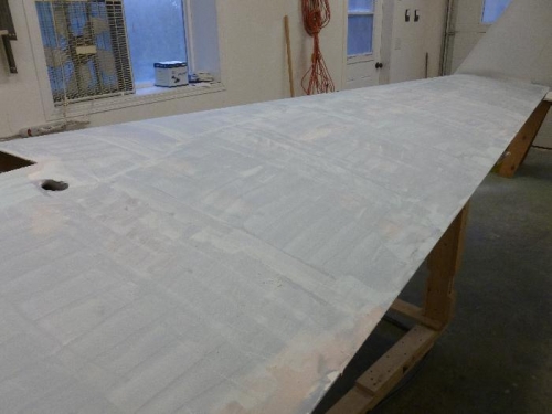

Added Spot-Lite to the top of the wings and sanded off filling in the scratches and finding more low areas to fill in.
I mixed up the Spot-Lite and spread out on the wing then I scraped it off only filling the scratches the applied again until it set up and I could not use it any more. I mixed up about 20 small amounts per wing to get it done. It was cheaper doing it this way then to spray out $75 in primer to just sand off. I used about $15 in bondo to fill the scratches.
I will now used Spot –Lite to fill and blend any low areas to have a smooth transition and shape for a great finish.
Spot-Lite on wings
Spot-Lite on wings
Bondo sanded off
Bondo sanded off
Scratches filled in
Scratches filled in
