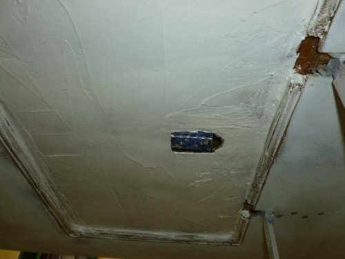

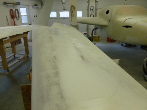

Brief Description:  Filling and sanding on the wings and speed brake
After marking low areas on the wings I had noticed very low area behind the hole ware the bolt goes in to connect to the main spare. The depression is 1/2" - 3/4" deep I mixed up some filler and added to the wing and I remembered that another builder did this and was told to remove this filler. I decided to phone Andy Millin and ask him what he had done to his plane. Andy told me that he had phoned the factory and they said that this is how the foam cores are cut and it’s NOT TO BE FILLED IN. Andy also said that others had filled it in and added extra weight to the wings. I will be removing my fill and go back to the natural shape of the foam cores keepping the weight down.
Thanks Andy for your time answering my question.
Wings got some sanding and fill

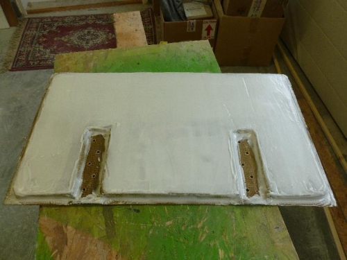

Speed brake got micro
