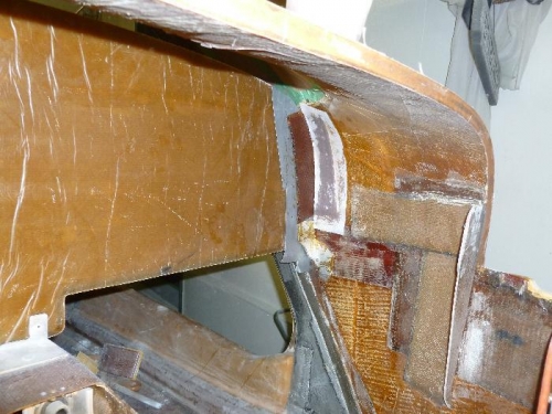

Brief Description:  Lay-ups for Instrument panel
Instrument panel was bondoed into place after leveling the fuselage and then the panel. Site was sanded and Acetone used for cleaning resin mixed and bushed onto site. I then started to wet out the 5 bid lay-up one at a time using the heat gun to flow out into the next one. The lay-ups were installed and peel-ply added again with the heat gun for flow out extra resin.
It was fun doing something other then fill and sand today.
Lay-ups in place
Lay-ups in place

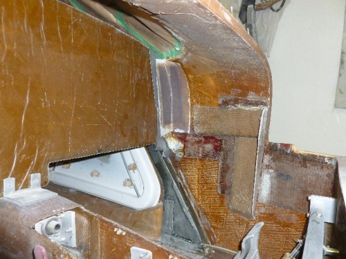

Peel-ply on with heat gun

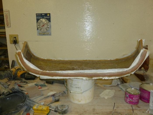

Dog house 1 bid lay-up
