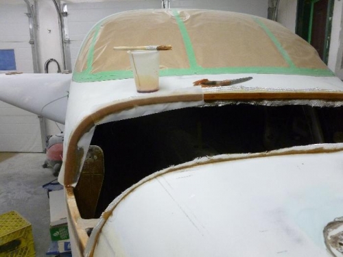

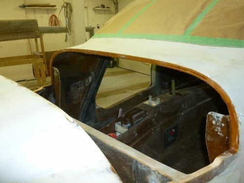

Brief Description:  Getting the dog house sanded to clearances
I worked on getting the dog house sanded to clearances needed (3/32) both sides. Then it was time to do a lay-up O My God I sure miss working with the cloth and resin. I did the fuselage side first and let set over night I then trimmed in the morning and checked for clearances. The one bid lay-up will be good on the dog house with 80% of the clearances just right and a small amount of filer will be needed for the other 20%.
Lay-up done
Lay-up done
Trimmed and will let set fully now
