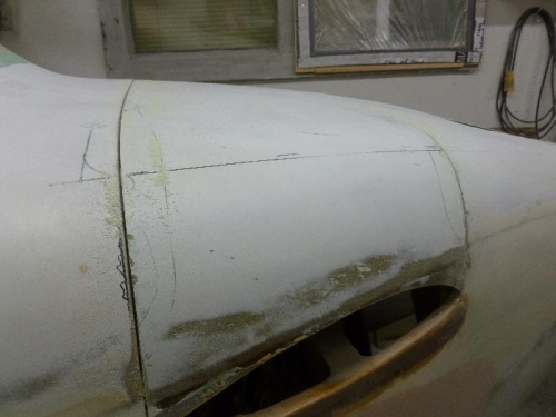

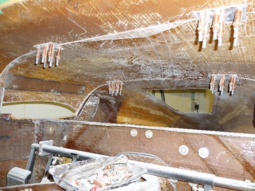

As I’m getting this ready for final priming the dog house is rubbing as it is removed and replace. I contacted Andy Millin and asked what is the best clearance for the dog house and his reply was 3/32 before primer and paint and this will leave a 1/16 gap in the end. I have grinding and sanding to get the area ready to re-bid, best to do this all now and not later on. I may have to do this as well on the top of the canard area to get ready for paint as well.
Dog house clecoed in place
Hand saw for better clearance
