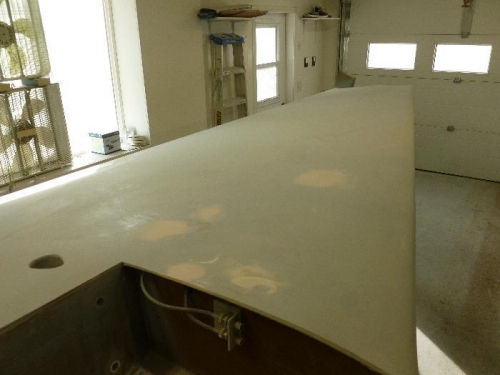

Brief Description:  Blocked out the wings today with the air board 180

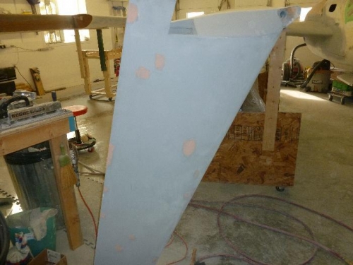

I got out the air board and started sanding the bottom wings with 180 grit paper from Princes Auto. It’s like a cloth backing and it should last for ever. I then did the surface with 220 grit paper and the imperfection sure came out and that lead to more Spot-Lite bondo work. The winglets got a working too.
Only a few spots to do
Blocked and a few spots got fill

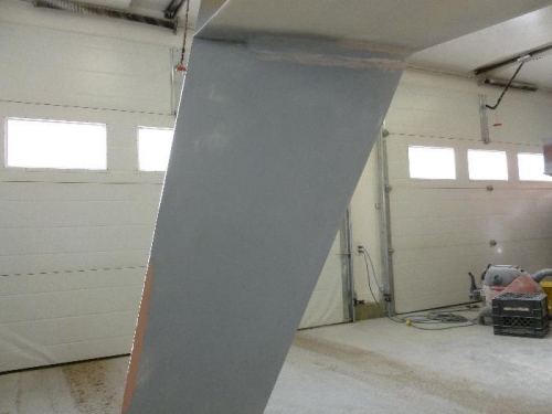

The rudder got some work
