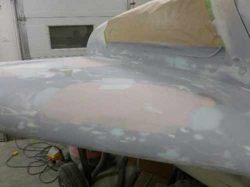

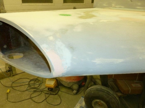

I blocked out the big area on the Co-Pilot side that I was not happy with and it turned out really nice, just had to flare in a few spots and it’s ready for primer now. I also worked on small stuff that will need work as well. It was a short night but I did get a few things done.
By the way I change the color of the hardener so that when I’m sanding and I see the other color coming trough this means I change to a finer grit paper to finish the blending this way. It works for me.
Big area blocked out nice

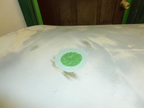

Work around the fuel cap
Small stuff needs work too
