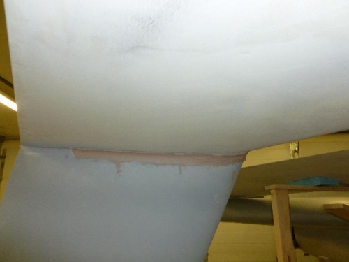

I got a few things done on the plane, some time is better then no time. I sanded the filets on the winglet to wing and tried some Z-Grip. A few builders use this filler so I gave it a try. It was very runny for overhead work so next time I will add micro to it so it will be thicker.

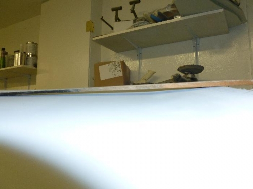

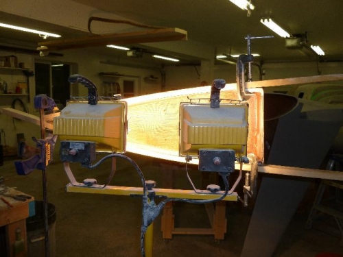

The wing ends were the preformed pieces were installed is bent up and will give problems when the cowling goes on, so I will try to heat and bend down to form. I’m not going to do any more filling in this area until I start to fit the cowling and see how it all looks
End of wing is bent up
Heating to reform shape
Z-Grip on winglet filet
