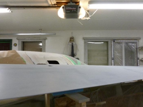

Brief Description:  More sand and fill to priming

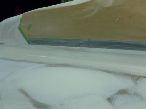

I started the day sanding the small bondo areas and moved onto the strake fuselage radius. The door grove on the under side to open the door was also sanded and shaped. I tried all kinds of round doweling to come up with the right sanding radius and a 1” seamed to fit the bill for the strakes to fuselage so I will stay with this. After the area was sanded and straightened I made a squeegee to fit the 1” radius and applied micro for the next round.

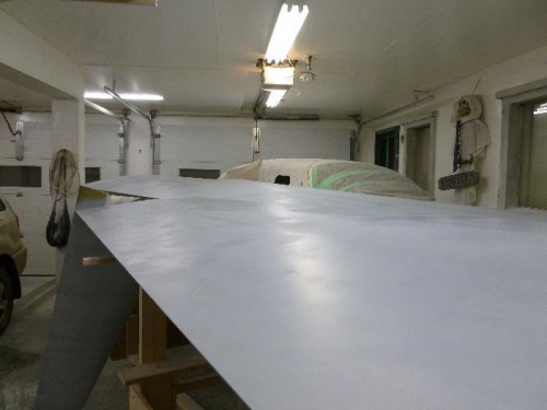

Now it was time to spray primer on the wings one more time for leveling. This is the fun stuff mixing and spraying in the monkey suit.
Sanded and radiuses one more time
Primed one more time
