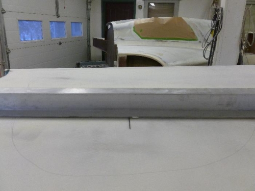

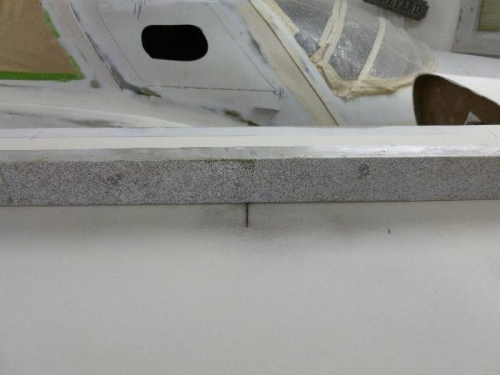

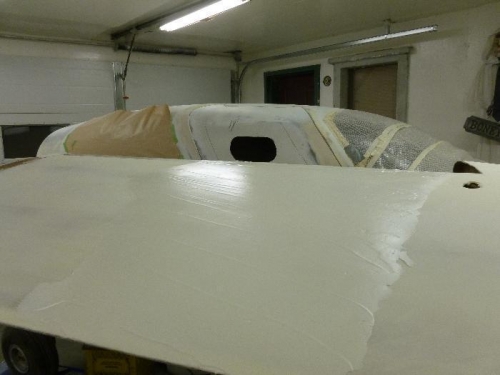

I did some sanding and prepped wings for more low area filling. As seen in the pictures I used the 3 foot sanding board to find the low areas and then filled in with more sand able micro. Slowly it is getting closer for the first shot of primer.
5/64 needed filling
5/64 needed filling
1/16 needed filling
1/16 needed filling
5/64 area filled in
5/64 area filled in
