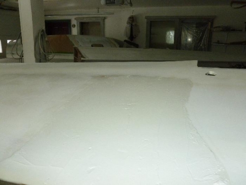

Brief Description:  Sand and fill low areas on wings

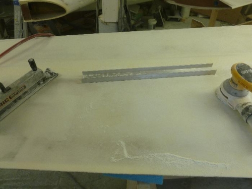

Time to fill in the big low areas to make as level as it can be. I use my Dewalt hand sander first to take off the high spots then the air board and a final with the hand board.
All sanding is done at a 45 degree angle in both directions to the length giving it straightness and flow up and down as well as left to right so far it is working out good only paint will tell the real story.
Tools used for this job
Low area from foam joint
