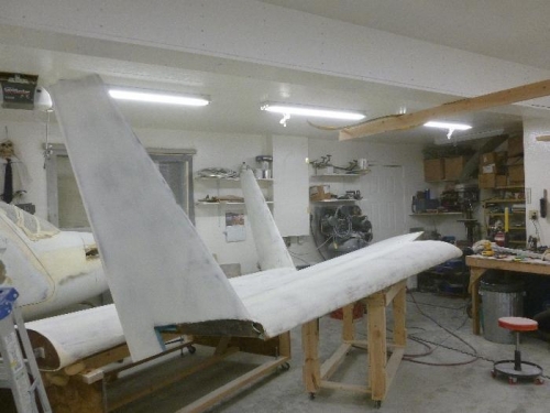

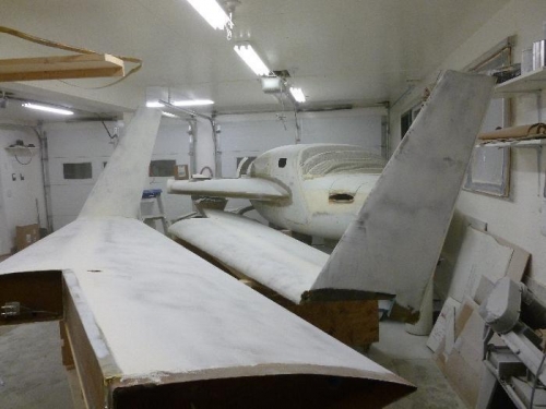

Brief Description:  Sand wings and winglets
Tonight I worked on sanding the wings and winglets. I used my oscillating De-Walt palm sander to nock off the high spots and then used the air board fallowed by the hand sanding board that came with the kit. The length was 5 feet so I cut it down to 3 and 2 feet to work with. I will have to sand a lot to have the flat finish needed for the great look.
This I hope is the 1/2 way piont 1,500 hours into the kit from 2 people
Sanding the icing
Sanding the icing
This is a very dusty job
