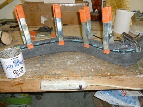

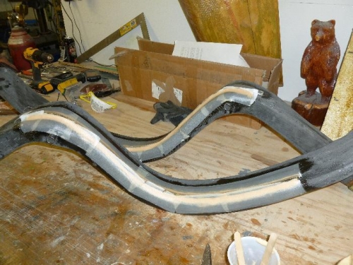

Brake line prep
I bondoed the tube in place and had to use 5 minute to hold the ends to get ready for the micro and glass work. The job worked out good.
Bondo and 5 minute epoxy to hold in place
Mirco and 1 bid peel-ply added
